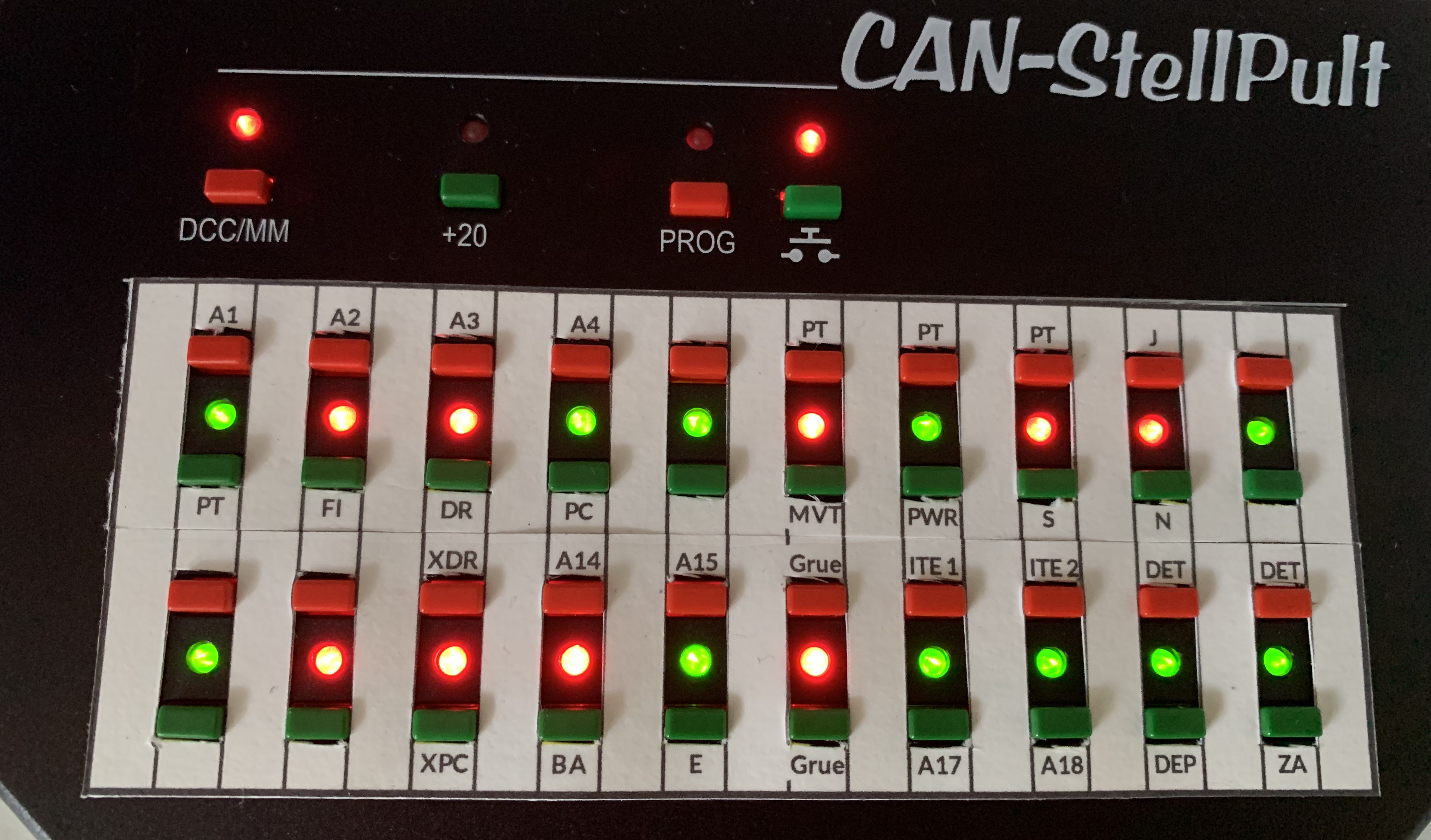

I will link the 1.6 version to the 2.8 version as I use the Stellpult with MS2 / Digibox.
Just an idea is to provide a mask that we can write references for the solenoids in use.
See attached files : JPG sample and .XLSX file to print the sample (unzip)
(Size: 1.93Mb, px: 4032x2367)
stellpult.zip  (Size: 8.68Kb, 1090 Hits)
