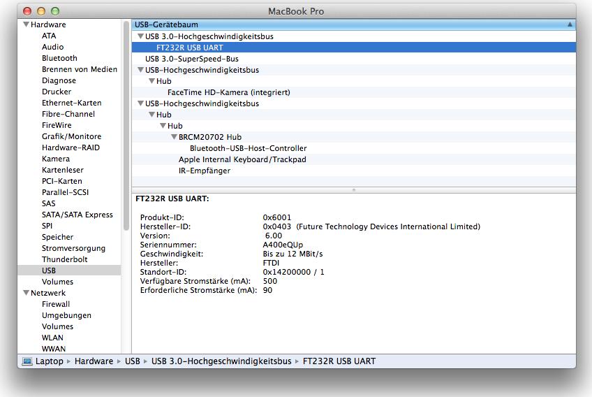

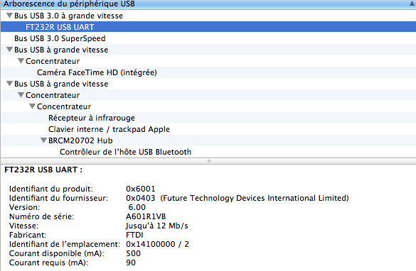

Here, you can see in attached picture, how the CC-Schnitte is on my mac
is the Rob USB to serial adaptor he use to test communication.
You can se that the product ID is the same. Have you a special PID for can.digital.bahn products?
Is there any error on the way the module is recognized ?
here comes the hardware info picture of my own CC-Schnitte-2.0 on MacBook-Pro, MacOS-X 10.9 with D2XX-Driver present (no VCP-Driver installed). Looks the same as your second picture.
No idea why there are problems... but Rob's FTDI-device is not added to the USB-highspeed-bus but to the normal USB-bus. Somekind strange. The external USB-ports of a MacBook-Pro should be always USB-3-capable. How is Rob's adapter connected to the Mac? Via cable or via Bluetooth / Infrared ?
